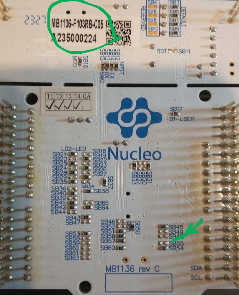

2025-08-15 2:06 AM

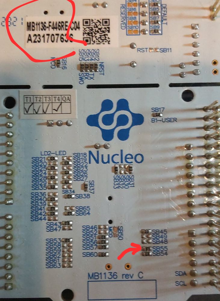

NucleoF446 has SB54 soldered
NucleoF103 has No SB54

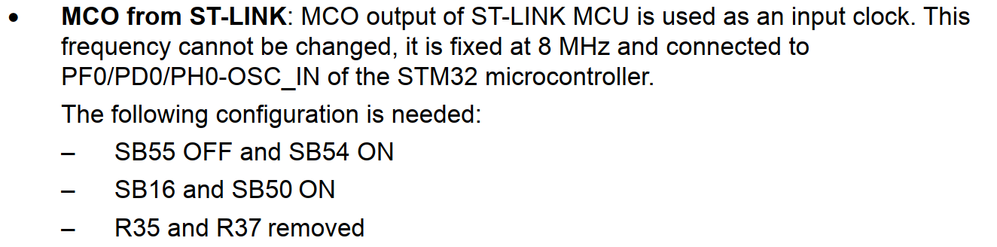

HSE bypass signal comes from the st-link. You'll need to match the solder bridge configurations as outlined in the user manual. The board doesn't have an HSE crystal.
2025-08-15 7:05 AM - edited 2025-08-15 7:12 AM
Dear TDK
Thanks for your comment.

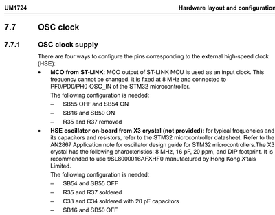

I understand your point. And I had read document of UM1724 also.
SB55 should be off for using HSE Bypass method.
In addition, both chipset has same Nucleo64 board so document is same for setting.
I am using NUCLEO-F446RE now.

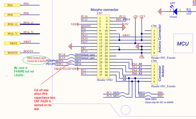

I am looking schematics of MB1136 SB55 and SB54 are junction to Morpho connector(CN7) PIN29, PIN31.
My trial is using HSE Bypass setting for getting 8MHz MCO from STLINK into OSC-IN of STM32-F446RE side.
But RCC-CR is not show HSE-RDY bit on this case.
I am wondering about whether SB55 solder bridge ON to OFF now.
Because of this effect is increase some capacitance on OSC-IN only.
But original NUCLEO-BOARD soldering bridge has delta on SB55.

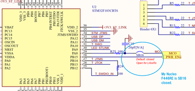

2025-08-15 7:11 AM - edited 2025-08-15 7:52 AM
STLINK MCO output SB16 is closed.
STLINK firmware has been updated with same latest image.
And NucleoF103RB is working fine, So STLINK should be right on this point.
But it should confirm with oscilloscope in fact.
According to UN1724 SB55 should be off.
Current NucleoF446RE is ON.
But I am not sure real meaning of this effect.

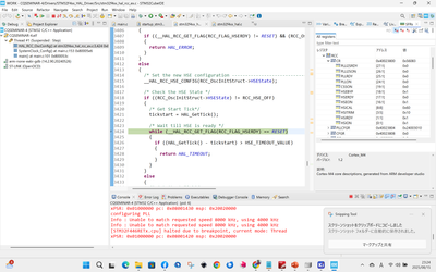

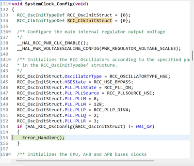

Failure happend at SystemClock_Config line 355 break as Error handler (HSE_RDY is not raised within time)
Dear TDK
In addition, I am planning to visit my labs tomorrow.
And try to monitor with oscilloscope on this case.
Now I can use CubeIDE debugging method from SW side,
Viewing RCC-CR bits shows not raised HSE-RDY bit.

2025-08-15 8:39 AM
Dear TDK
I have settled setting as UM1724
SB55 off SB54 on
SB16 and SB50 on (SB50 setting had been missed)
R35 and R37 removed
Now it worked thanks for your support.
