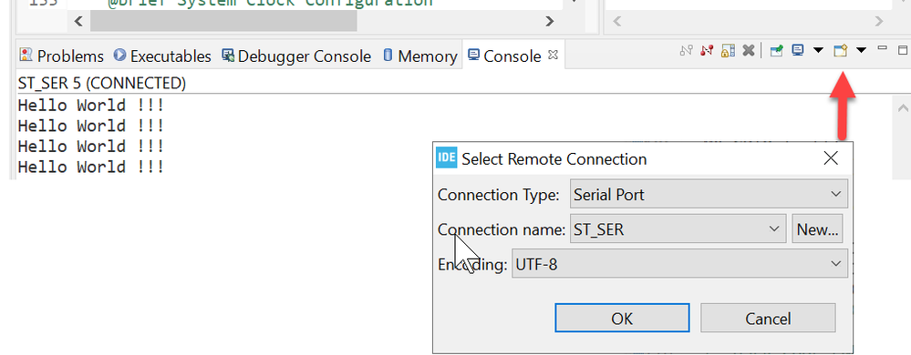

I can manually start Tera Term and connect Serially, but I cannot find how to do this from within the IDE. Is this possible? Maybe a project option that needs enabled?
Using STM32CubeIDE 1.6
Thanks

I just found it. If you click enough buttons (I could not find where the info is in help).
The info I found online showed the icon for the 'Display Selected Console', so it added a bit of a twist.
Here is how to invoke:
Cheers,
