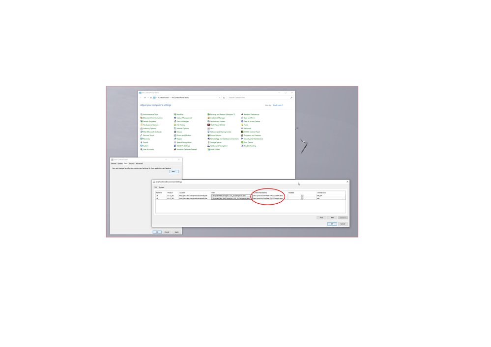

Update - Solution: in case it helps:
I found some older threads suggesting that turning off direct32 in Java made a difference. I didn't work that out for myself but I'm posting this because I couldn't find any simple documentation showing how to implement it.
I did it as follows:
I did it for both lines. I assumed it should only be required for 64-bit but I couldn't tell which was being used.
Result: Changing a pin definition now takes about 1.5 seconds instead of > 30 seconds.
(If Java gets updated, it may be necessary to edit this again - I have no idea).
