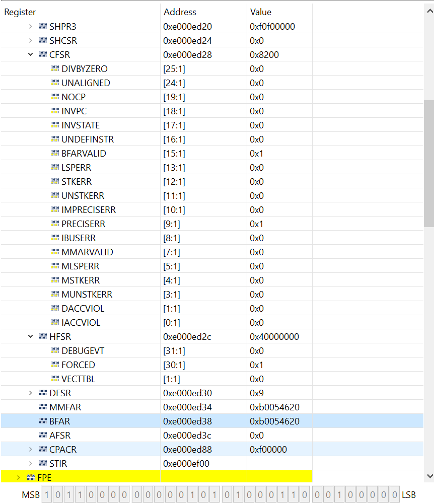

I came across a HardFault in my code while in debug mode on STM32CubeIDE, and I checked the SFRs register viewer and noticed that I ran into a PRECISERR, and the BFAR field shows which address triggered the data bus error. I have attached a screenshot of what my SFR window is showing, including the address stored in BFAR:
Knowing that the BFARVALID bit is set, and my BFAR points to 0xB005_4620, is there a way to check which line of code resides in this address on the STM32CubeIDE?

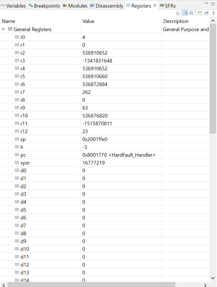

I know that if I pause the Debug mode on STM32CubeIDE, and I place my mouse cursor on the functions/routines like, for example, HardFault_Handler(void), it shows me that the HardFault_Handler resides in 0x800_1770. Even the pc register in Registers window tells me that 0x800_1770 points to HardFault_Handler(void) as shown below:

Thanks for the response! It did not occur to me that 0xB005_4620 isn't in FLASH or SRAM. Since this is the case, why would the BFARVALID bit be set and why would BFAR point to that address?
Do you also have any tips or pointers on why a PRECISERR occurs, and how to identify the source of the issue?
2021-06-23 1:28 PM
Nothing other than basic debugging. Look at the call stack from within the handler to see where it crashed, if available, and examine that for problems. Barring that, step through the program to narrow down where it crashes.
BFAR is not necessarily the address of the instruction, it could also be the memory an instruction tried to access. Try reading from 0xB005_4620 and see if you get the same result.

Thanks for the response! I did examine the PC and LR registers after the HardFault_Handler() got executed, and the PC pointed to the HardFault_Handler() function, while the LR register contained a value of -3 (based on the second picture posted in the question).
