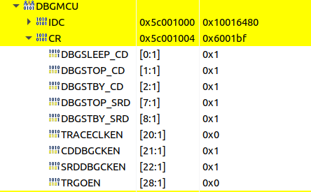

Using STM32CubeIDE 1.3.0, content of debug control register is "0x6001bf" which should be fine for debugging in low power mode.

Did you enable the needed bits in DBGMCU_CR of the needed CPUs?
2020-03-17 5:54 AM
yes, it's in the text above, that content of debug control register is "0x6001bf"
