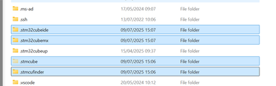

2025-07-15 9:08 AM
where can i find those files : .stm32cufinder, .stm32cubemx, .stm32cubeide and .stm32cube
2025-07-15 9:41 AM - edited 2025-07-15 10:01 AM
oh...
on Linux : in your home directory,
on Win...first set file browser settings , to show "hidden" and system files, = all files;
also in your home directory,
on what system you are ?
