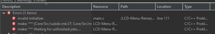

My first time posting on this forum so apologies in advance. I am working with an LCD screen that will have multiple menu's so I designed this struct with multiple pointers. However, I am running into this error where I cannot seem to use malloc function. It just keeps saying 'invalid initalizer'

menu newMenu = (menu*)malloc(sizeof(menu));
Error:

Where, exactly, is that error reported? it says line 111, but the posted code only goes up to line 92.
Are there any other errors and/or warning?
Show the actual compiler output - it (usually) gives more detail.

Appreciate the quick response, I just posted this but immediately noticed the issue I was just missing a '*' on my definition of my variable.
