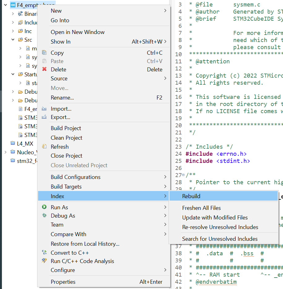

A few things to check:
If I misunderstood the problem then please let me know. A detailed step-by-step to reproduce the issue is always appreciated!
