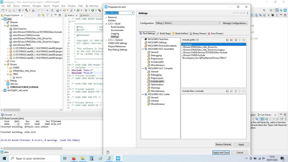

Hello, I recently had a compilation error with STM32CubeIDE 1.14.0. A json.h file is not found by the compiler, yet I have included the path in the project properties, as shown in the photo.
The file is present in the project/drivers/JSON directory. If I move the file to project/core/inc, the compilation works.
Another oddity, I can't find where the paths to project/drivers/NTC and project/drivers/OLED are registered? Yet the compilation works (without json.h).
Thank you.

strangely with a new project, the inclusion of a new.h file works well with the configuration screen.
It must be an option in the properties, but I don't know how to modify that......do you have an idea?

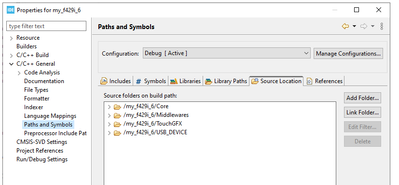

Hello
It seems that your /drivers/- folder is not source-folder because there is no blue c- letter.
Check 'paths and symbols' -> 'source location' list from your project properties and add it there if needed.
Br JTP
2024-07-09 8:51 AM
@JTP1 wrote:It seems that your /Drivers/- folder is not source-folder because there is no blue c- letter.
Indeed:
Not sure what that icon on it is, though - is it a key ?
Does that mean it's somehow "locked" ?
