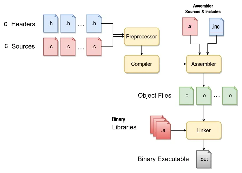

On the distinction between source and binary:
Traditionally, "Library" was used to mean a pre-built binary library.
Nowadays, people also commonly speak of source-code libraries.
https://www.stackzero.net/compilation-process-in-c/

Thank you so much for your help. I really appreciate that. I'm used to using Arduino and I'm still learning to program with the STIde. So thank you so much.

Yes, one of the things that the Arduino IDE "hides" from you is these details behind adding a library.
