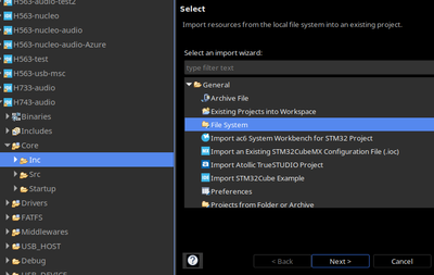

2024-02-26 5:11 AM
maybe error msg is right ? There is no such file...
So you have to "import" it : right click on the directory, you want it to be ->
next -> browse the source , select what want - ready.
This for every source .c or .h (or group of ..) , then the IDE got it.

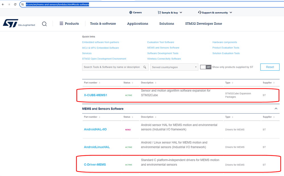

I suggest you look at the X-CUBE-MEMS1 and/or C-Driver-MEMS software packs:
https://www.st.com/en/mems-and-sensors/lsm6dso.html#tools-software
