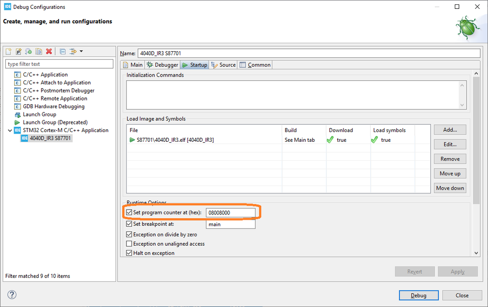

2020-01-09 3:37 AM

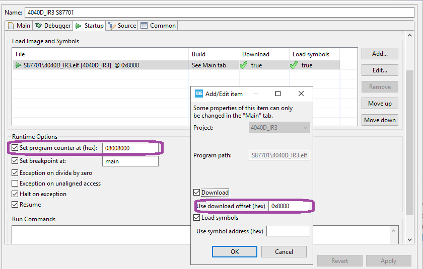

This is after I specified starting address

2020-01-13 1:07 AM
How do I see entire conversation?
From the post at https://www.openstm32.org/forumthread2364 I understood another step, but it still didn't help the debugger to know where to start...

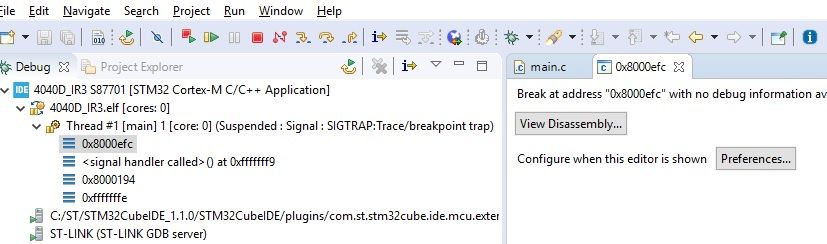

2020-01-13 1:26 AM
I upgraded to STM32CubeIDE 1.2.0 - still no change...debugger insists on starting at 0x8000efc!
