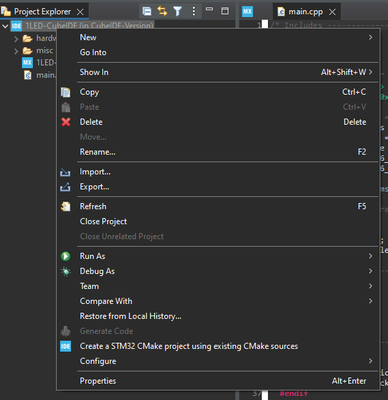

2024-07-09 8:20 AM
Hey Pavel,
Thanks for the quick reply.
I set up the project already as "C++" in the "STM32 project" wizard when I generated it.
Or do you mean somewhere else? Because there is no "Convert" option in the right click menu:
Regards,
Hannes
2024-07-09 11:33 AM - edited 2024-07-09 11:37 AM
Hmm. Strange.
Try to import some example and see how it looks in the Project explorer pane.
