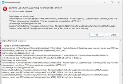

2024-08-29 4:06 AM
Dear Metyus,
Thank you for the help, I tried what you suggested. I got an error which I attached long with this reply. Can you help me in this regard?
Thanks,
Neelesh

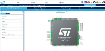

2024-08-29 8:39 AM
Which processor? Can you please attach the project you have imported. Please attach the details....

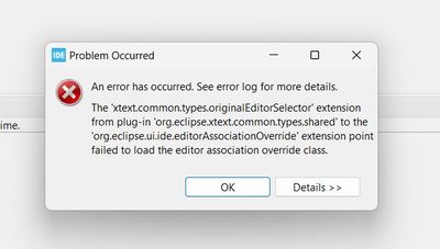

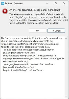

2024-08-30 6:26 AM
Thank you for helping.
I tried as you suggested and this time binaries and .elf files were generated.
But I have another issue now. can you give me any suggestions?
2024-08-30 8:24 AM
If it works, please accept it as solution so that it will be useful to others.
Regarding your issue, are you able to program the devices? Make sure that you enable the debug pins in the cubeMx.
2024-08-30 1:45 PM
Another issue? is there a debug or run configuration (.launch file) copied from other machine? Delete all these .launch files and create new debug or run configurations.
