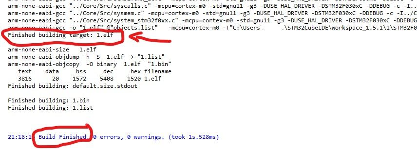

Cartu38 OpenDev
Lead III
.elf file generation and location is promoted as part of build console log
0693W000007EBkBQAW.jpgFirst build your project. Wait for completion then create a brand new debug configuration ... STM32CubeIDE should found .elf file by itself
