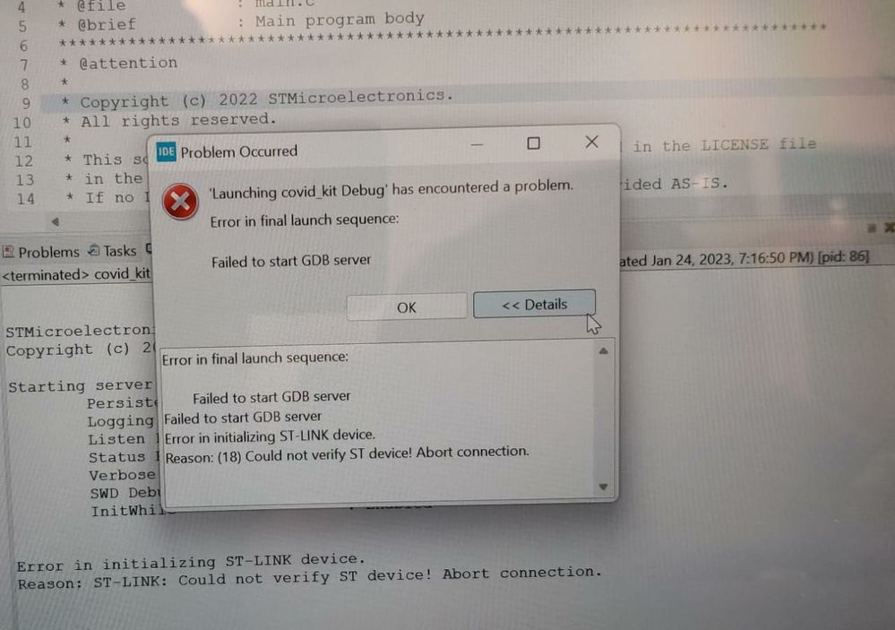

I have tried both ie. using another original ST-link V2 and by resetting the BOOT0 pin. Still the code is not uploading...
Just to clarify- I am programming my stm32f103c8t6 based custom made pcb with ST-Link V2 via I2C (Vcc, Gnd, SWCLK, SWDIO).
in this case, Are these 4 pins enough to program the uc or is setting/ resetting of BOOT0/ BOOT1 pins required ?

Sharing the screen shot of error that pops up.
Also, STMCubeProgrammer detects the ST Device with the same hardware setup.
2023-01-24 6:06 AM
So, you are able to connect to the board using STM32CubeProgrammer but not with STM32CubeIDE!

Below attached is the error message i get.
And yes u r right, ST-link v2 i am using is not the original one then.

2023-01-24 7:54 AM
So, you have an illegal ST-Link clone which ST does't want you to use (it still partially allows it, but slowly the policy is being tightened) and, very likely, you are trying to debug a STM32F103 clone, which violates the STM32CubeIDE license.
ST Microelectonics software still (maybe not for long) PARTIALLY works with ST-Link clones and ST MCU clones but this support is shrinking with every new release of software.
