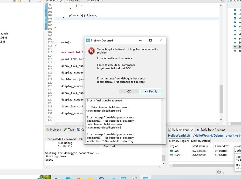

i am using a STMCubeIDE v1.11.2 with windows 10 when i creat a new project it is working if i closed the IDE and open it again the problem below occure
Error in final launch sequence:
Failed to execute MI command:
target remote localhost:٦١٢٣٤
Error message from debugger back end:
localhost:?????: No such file or directory.
this is a screenshot for the problem

2023-03-24 8:51 AM
this is number is 61234
2023-03-24 9:10 AM
I changed the number system of the windows from arabic to english and it is working now
