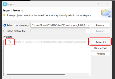

I put this folder in the workspace with all the other projects:
Now I have to import it as I have always done: file - import - existing projects in the workspace
I cannot press on "finish"
You have to select something to import!
Either check the box next to your project name, or just use the 'Select All' button:
The problem is that it won't let me select it..
But I think I figured out why, there is a warning that the project already exists in the workspace .. probably because the folder name to import is different from the actual name of the .ioc project inside.
I lost an hour because I thought I was importing the wrong way.
I will update you
TDK
Super User
If the project is grayed out, it already exists in the workspace.
I put the project folder on the desktop, imported it and now it works. Perfect!
The question is ... I don't want the project on the desktop, I want it in the workspace folder with all the other projects (C:\Users\me\STM32CubeIDE\workspace_1.8.0\myproject) how do I proceed?
I delete the folder from the desktop because stm32cubeIDE automatically creates it in the workspace? (I did and it seems to have happened like this)
@Andrew Neil @TDK
TDK
Super User
You can remove (don't delete) the project from the workspace, move the folder, and re-import it from its new location. Don't think you can move it once imported.
