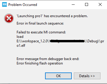

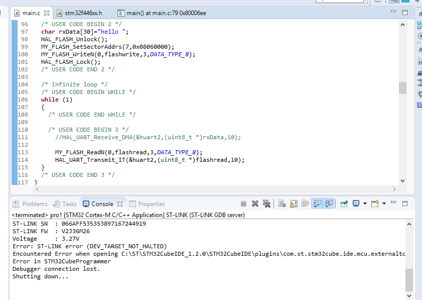

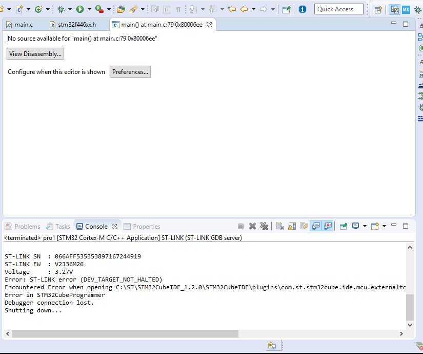

I found a user created library file from github. But the problem i faced was after every time I run the program i need to erase the whole chip and update the firmware. If didn't do so so I couldn't upload the program.
It comes as this error
should i add thesefunction.
HAL_FLASH_Lock();
HAL_FLASH_UnLock();
i face the same problem even afterthat
Please help me.
