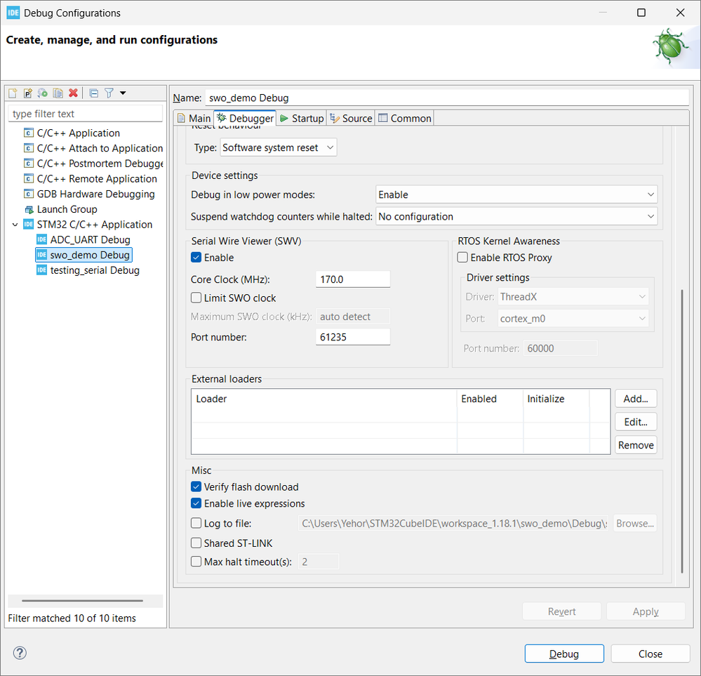

I'm figuring out the redirection of `printf()` function to ITM Data Console on example of Nucleo-G474RE.
I managed to set-up the forward of `printf()` to ITM Data Console when it is used in debug-mode, but I can't use it when it is build with regular Run command. The start trace button stays grey and unavailable. However, I can connect to SWV with STM32CubeProgrammer. Which setting am I missing?
The example code is simple and based on STM32 project without BSP. Code is:

/* USER CODE END 3 */Project configuration is:
System info:

Use some tool that can read ITM trace without the IDE. For example, the Cube Programmer or something based on OpenOCD, pyocd. Note that these tools will anyway enable the debugger interface (SWD pins and DBG) because the ITM is part of it.
