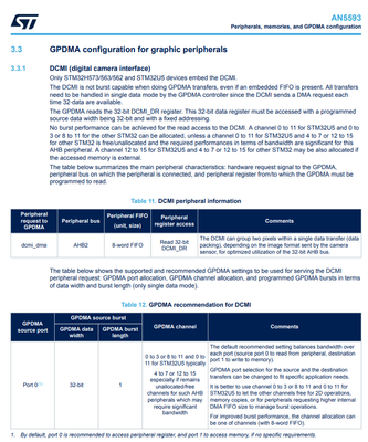

Also you can use the GPDMA Linked-List mode without issue. For that I recommend you to refer to the DCMI_ContinousCap_EmbeddedSynchMode example. This example can help you to start with GPDMA and DCMI.
Also, please take a look at AN5593 How to use the GPDMA for STM32 MCUs precisely section GPDMA configuration for graphic peripherals.
