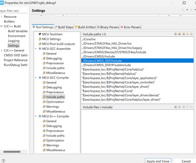

Hi @baby_chicken ,
Could you please add the ../Drivers/CMSIS_DSP/Include path and the ../Drivers/CMSIS_DSP/PrivateInclude path to "MCU G++ Compiler" "Include paths"
Thank you;
Kaouthar

2024-08-28 6:17 AM
@Andrew Neil ,Thank you for your response.
I think I am setting Include Paths here, but what's the difference?

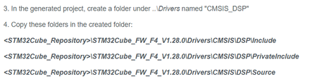

Hi @baby_chicken ,
Are you copy the Include Drivers from STM32Cube_FW_F4_V1.28.0\CMSIS\DSP\Include to your generate project?
For that please, ensure that steps 3, 4 and 7 shared in the FAQ are followed properly.
Thank you.
Kaouthar

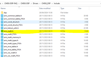

2024-08-28 7:23 AM
@KDJEM.1 ,Thank you for your response.
I just checked and copied it to the project generated from STM32Cube_FW_F4_V1.28.0\CMSIS\DSP\Include.
best regards.
