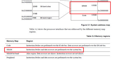

2024-09-09 6:01 AM - edited 2024-09-09 6:03 AM
For the SRAMs used for data they start at 0x20000000. This is basically linked to the ARM specification and performance: need to refer to Cortex-Mx TRMs.
Example from Cortex M3 trm:
But some other SRAMs start at 0x0 for example ITCM (Tightly Coupled Memory) for F7 and H7 families. In any case, you need to check each STM32 part number datasheet.
