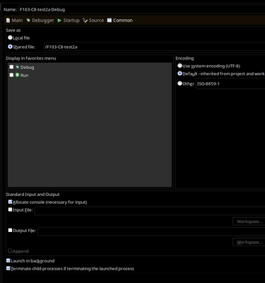

Just make/edit a new debug or run configuration and set it to....what you want:
2024-08-30 12:36 PM
Thank you for the information.
How exactly should I set this up?
Aren't the build configurations and run configurations meant for setting up how the build artifacts are debugged or run?
I am specifically looking to designate an output directory for the build artifacts.
For example, I would like to create a build directory under the project root, and within that, have separate release and debug directories for the output. In the future, I also plan to create separate directories under build for unit test build artifacts.
2024-08-30 1:11 PM
Come on... read the manuals and the how-to-use ...
then right click and create a new configuration...as you like, set it. Thats it. Try...
2024-08-30 1:58 PM - edited 2024-09-01 9:02 AM
These debug config screens are not related to build directory. Edit the makefile, find any definitions/macros that can be changed in make command line or environment.
Choosing makefile as the project type usually means that developer is comfortable with makefiles [and is smarter than IDE & mouse clicking folks].
