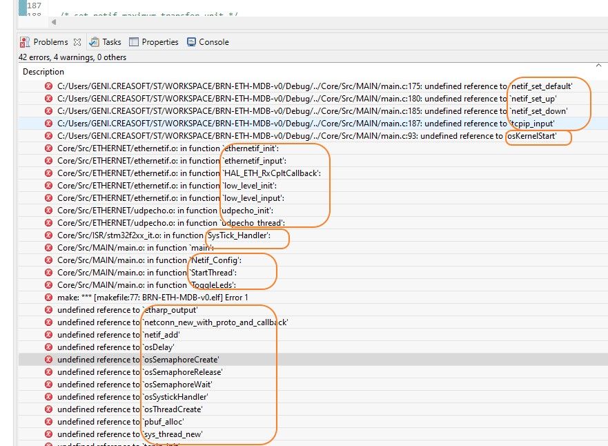

I'm trying to compile a project with FreeRTOS integration and Liwp lib for Ethernet comms.
It's not my first time using this IDE and making projects with this thirdparty libs. But it 's the first tiem that I have seen this kind of problems.
But for some reason, that I'm unable to answer myself, I have got several building errors related with objectos (vars and function calls) that are defined and declarated on a files that I'm including there. Some sample of the kind of error mesages thrown by console.

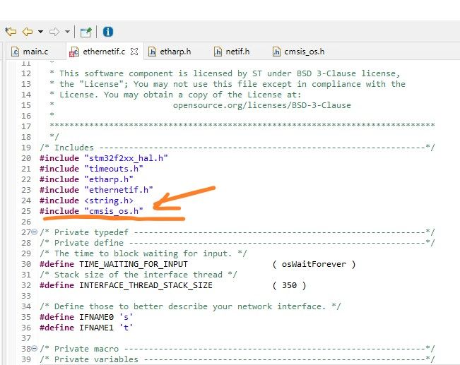

I have checked the "link connections" within above orange marked expressions. Let's go to the first line error. I went to the file I found the undefined reference is an expression defined on cmsis_os.h file. I check the file inclusions, those from where error are reported. And I can see thins like this:

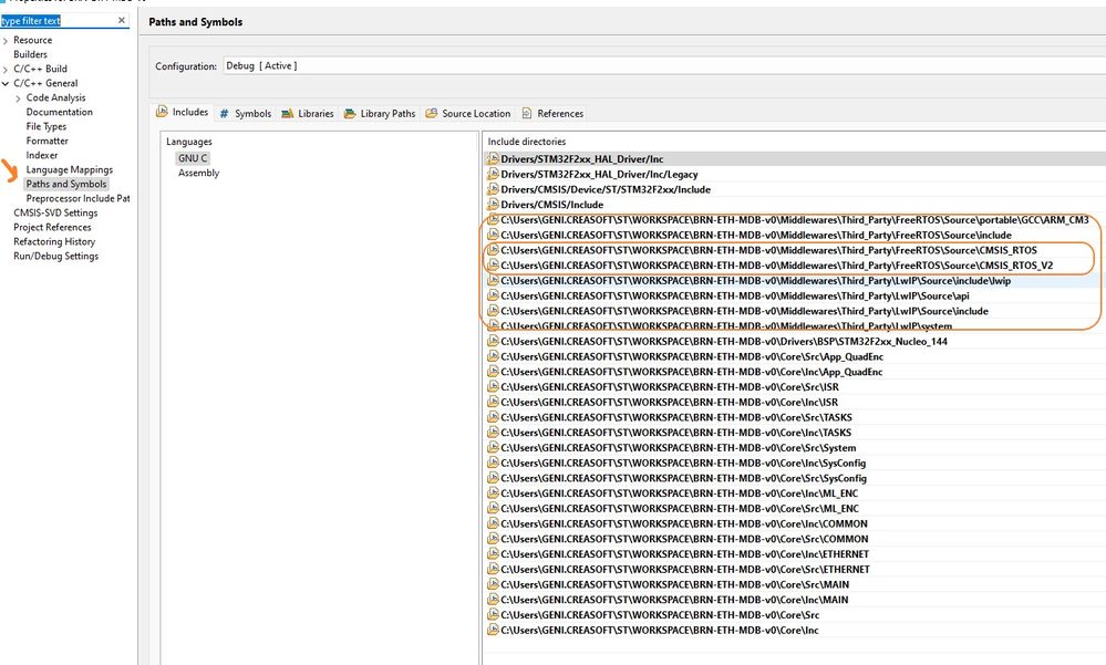

Hence, I quickly went to see how the paths were included to the project. Folder where those files are found are added to the paths:
All features seems to be ok in order to the references to be found by the compiler. But it stills not doing that.

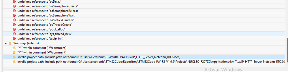

I would like to add some other kind of information from console that could be useful. Console is also launching 2 warnings related to paths that are unkown for me. I don't know from which file are trying to include those paths and why:
Maybe this is related to the root cause of the problems before commented.

No, console tab doesn't show me any message about the other projecte folder warnings. That's the point of my question. I was unable to find any more reference about it on the project logs (I was looking for that information specially on the console messages). But after clicking every tool I found the problem. It was an interface bug.

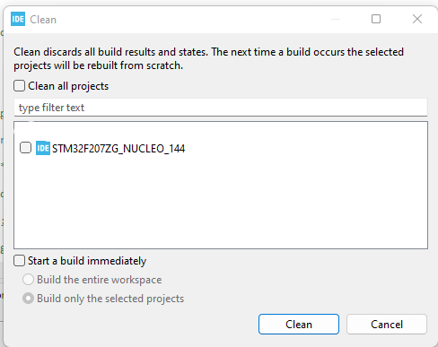

6.- But once I went to "clean" from project menu (uper tool tab) a new tab was opened and it shows me that there was another project there. The project related to the warning folder.
Look at this image:
7.- I removed the check mark and I cleaned.
8.- After clean it I compiled the project once again and this time warnings about the other project dissapeared.
After this action a lot of compilation errors were removed. Although there stills some of them, now the references problem location was easy to solve.
