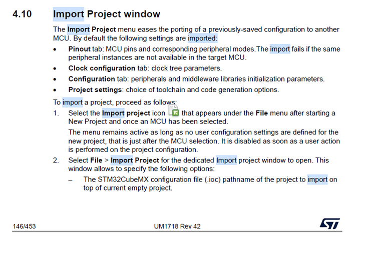

Official create new project and import ioc into it. (imported is pinout and setings)

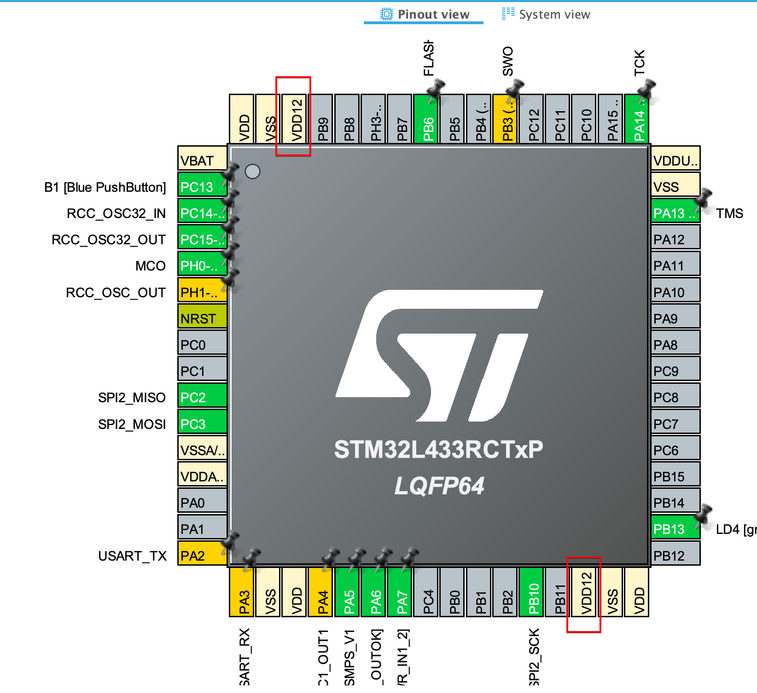

But when I open the .ioc in STM32CubeIDE, it still shows the VDD12 pins (which are only used on the STM32L433RCT6P)

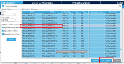

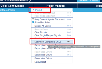

You may use "List Pinout Compatible MCUs" option,
Then look for STM32L433RCT6 in the list and click "OK import"

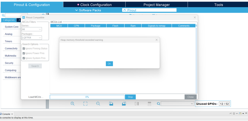

I tried that but get the error "Heap memory threshold exceeded warning"...
What does this mean ?
This is what it shows when I build code...

It seems to be an issue with Java and the numer of parts searched for.

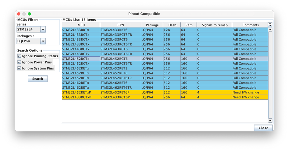

If I narrow the search by selecting the series (STM32L4) and package (LQFP64) then it works... BUT, there is no Import (or Export) button, just a Close button....
