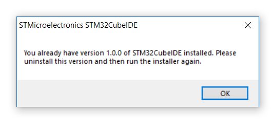

When I firsts Installed the STM32Cube IDE got all kind of error in paths and other stuff, so tried to uninstall it, the uinstallation was always freezing and I deleted the folders. Also, tried to delete some registers but could not find anything more..
So, when I try to install it again, I get this message.
What should I do to force it to install?
Also, I ve Atollic 9.3.0 installed and my current project is beeing developed on it.

dpkg --remove --force-remove-reinstreq st-stm32cubeide-1.6.1

In case someone deleted the /opt/st folder (Ubuntu), And the installer says there is "nothing to install":
"UM2563 STM32CubeIDE installation guide" says to run this command:
The uninstallation of STM32CubeIDE depends on the distribution. Uninstall STM32CubeIDE according to the step
below corresponding to the distribution used:
• For Debian-based distributions (such as Debian®, Ubuntu® or others):
sudo apt-get remove st-stm32cubeide-xxxx st-stlink-udev-rules st-stlink-server segger-jlink-udev-rules
But for me this one worked:
sudo apt-get remove st-stlink-udev-rules st-stlink-server segger-jlink-udev-rules
I just installed Xubuntu 22.04 and Initially STM32CubeIDE froze right after being installed. It did nothing but hover over a menu and nothing could be clicked, nothing could be triggered, not even a terminal window. Had to force shutdown manually on the power button. After that the IDE could no longer be initialized. I found something on the Internet about a .lock file in the WorkSpace folder, but it didn't do anything to remove that file.
It would be nice if the installer could check what's missing, like the /opt/st folder instead of just saying there's nothing to install.
