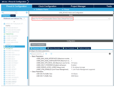

I'm trying to transfer data to the upper computer using virtual port com on STM32G473RET6.
But how to recognize USB ready before transfering data?
