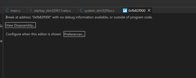

I'm having trouble making the delay function in stm32f411vet. When the power frequency for the chip is 16MHZ, it still works normally but when the frequency is increased to about 64MHZ, the error occurs. Let me all ask you what fault this is.
