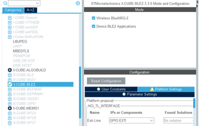

Hello everyone. I got a STEVAL-IDB008V2 board including an BLUENRG-232. I want to program it from scratch, but I couldn't find a BLUENRG in the STM32CubeIDE Target Selector. Is there something that I'm missing? Thanks for the help in advance.
2023-10-19 3:05 AM
Hello @MrEmou,
The STEVAL-IDB008V2 board is not supported, that's why, it's not available in the selected board list.
If you want to configure it, I suggest that you install the X-CUBE-BLE2 pack.

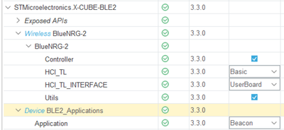

In order to configure the BlueNRG, please follow steps mentioned below:
1- Create new project using STM32 MCU
2- Select component under Software packs
3- Enable the X-Cube-BLE2 with your configuration, then press OK
4- Configure your pack under Software packs available in the category part
The image attached will help you to understand the steps described above.
Thanks.
