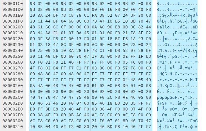

The main idea is to save the name of the
FW version in ASCII on a defined placed in flash. So e.g. the factory has the
chance to open (or read out) the hex file and determine what FW version this
is.
We already noticed, that the same location the beginning between the different controller families (STM32G0 / STM32G4) can be risky, because the length of the vector tables varies.
This means at the beginning the offset must be away for the maximum length of the interrupt vector table the make sure not to crash.
There are pros and cons to place this FW information at: ".ARM.__at_0x08000200"
At this place it’s easy to find and should work for all the G4 family.
However, to place the FW information at the end of the flash would quire to place it individually for each G4 controller size.
What’s your thoughts ?
