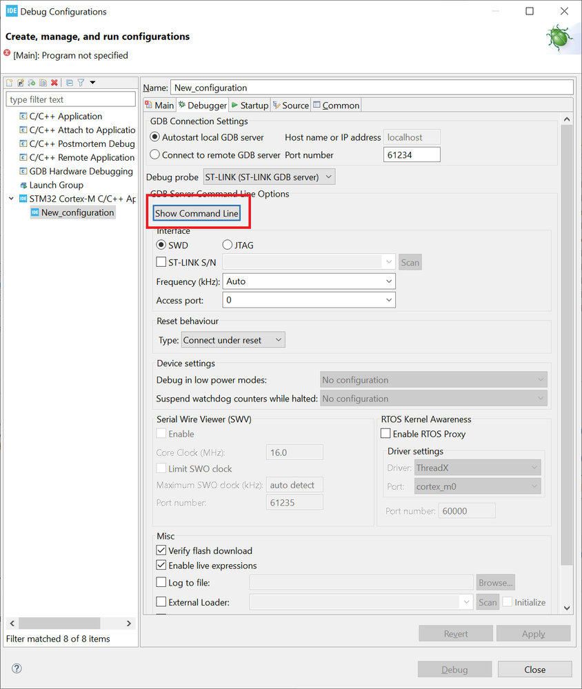

Hello again Venkatesh,
Are you using J-Link or ST-Link GDB server? The error indicates that it can not find an ST-Link connected and the Port Number that is being listened to is 2331, which is the default for J-Link.
You can go into the debug configuration through the GUI of your application and see the exact command line that is being used by clicking on the button highlighted below:

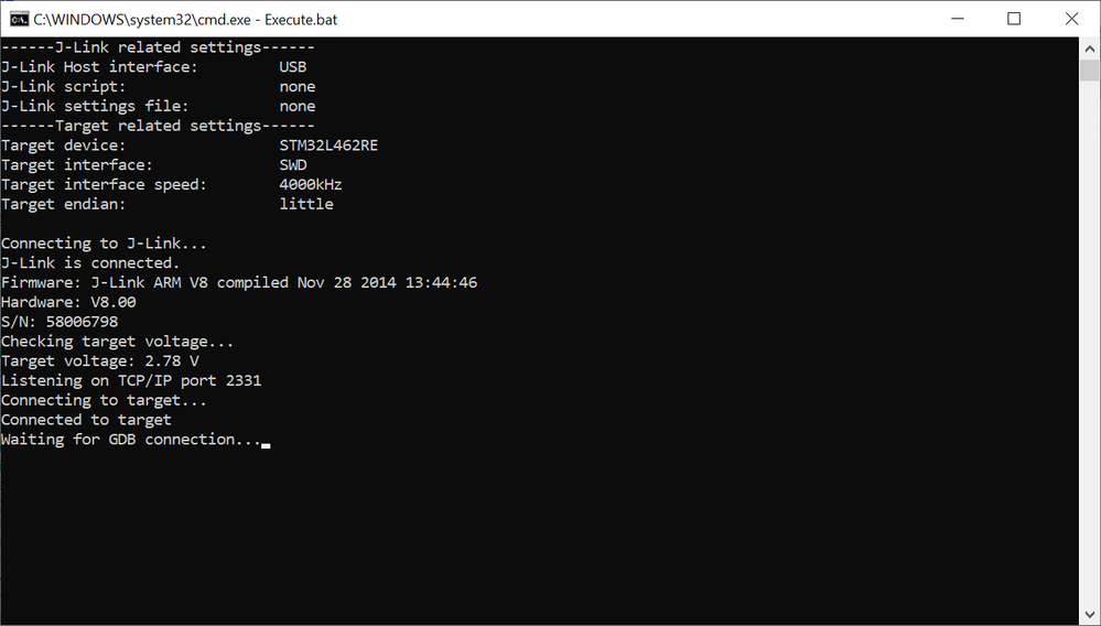

2021-10-21 5:06 AM
Thanks so much or your support
If I execute from GUI everything is working fine
As per your guild line, I have copied the command line pasted in to one batch file
set STM_base_dir=C:\ST\STM32CubeIDE_1.7.0\STM32CubeIDE
%STM_base_dir%\plugins\com.st.stm32cube.ide.mcu.externaltools.jlink.win32_2.0.0.202105051205\tools\bin\JLinkGDBServerCL.exe -port 2331 -s -device STM32L462RE -endian little -speed 4000 -if swd -vd
When I execute same command from command prompt, it will stuck
Please give your inputs to resolve this issue.
2021-10-21 5:29 AM

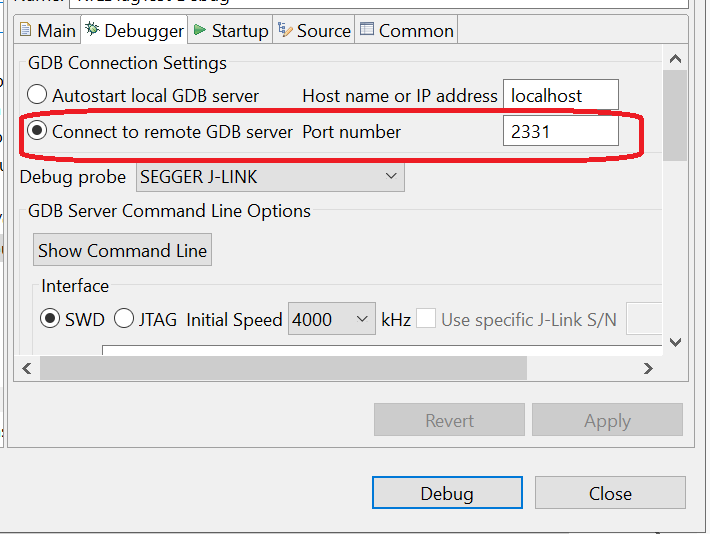

Hello again!
It looks like everything is working as intended in the screenshot of the command prompt window. The launch has succeeded and it is now waiting for the GDB connection.
If you plan on using command line then you will need to change the GDB Connection Settings in your Debug Configuration from "Autostart local GDB server" to "Connect to remote GDB server".
Since you are using J-Link any additional commands will need to be found in the J-Link user manual and not the ST-Link GDB server one. However, you can find some additional information regarding debugging and the debug configuration in the STM32CubeIDE user manual, UM2609, in chapter 3.
2021-10-21 9:26 PM
As per your guide lines, I have selected "Connect to remote GDB server".
Still I am getting same error.
Please give me inputs to resolve this issue.
Thanks in advance
