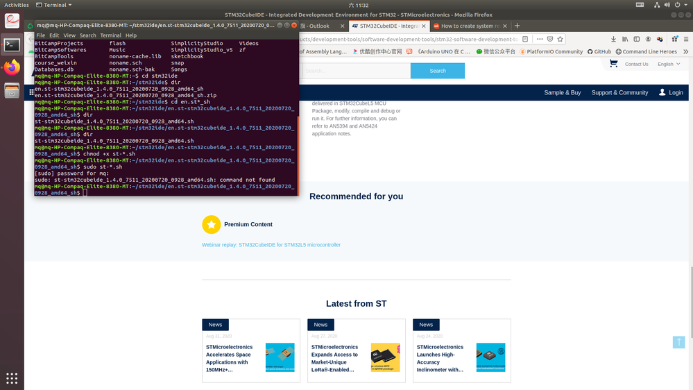

I deleted the directories, and downloaded again, unzip--> chmod +x --> sudo ...
it was the same:

Julien D
Well not exactly the same. Those are actually basic Unix mistakes with shell usage.
In short, when you enter a command, the shell does a lookup in paths declared in $PATH variable.
Since the current directory, aka '.' (dot) is never (or should never be) part of this variable, the shell returns 'command not found'.
See "echo $PATH" or 'env' to control what is in your environment.
To make it working I suggested you the simply use:
./st-stm32cubeide_1.4.0_7511_20200720_0928_amd64​.sh

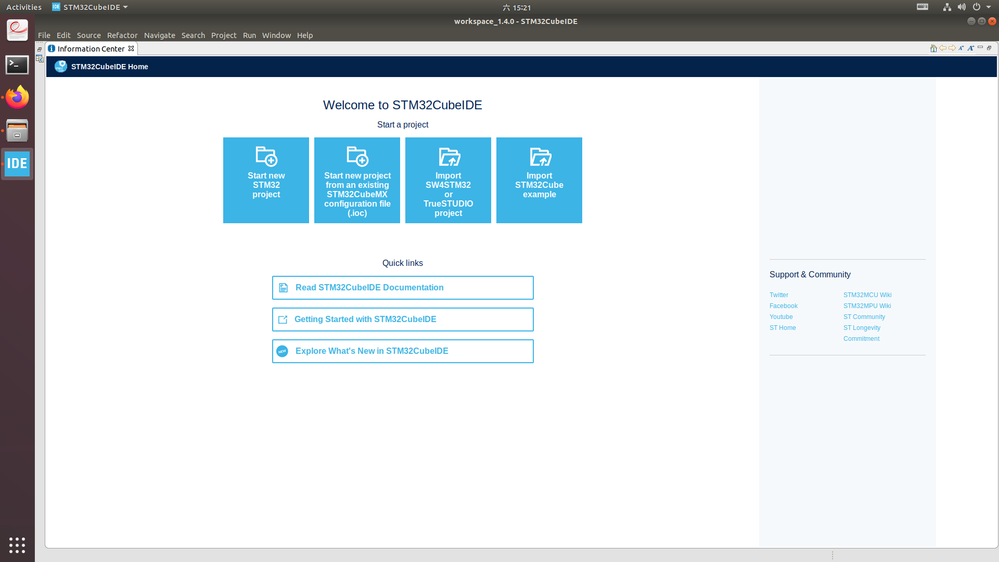

MQi.1
Senior II
I can see the icon now, and I could launch STM32CudeIDE there.​
https://ibb.co/9ystFMV
