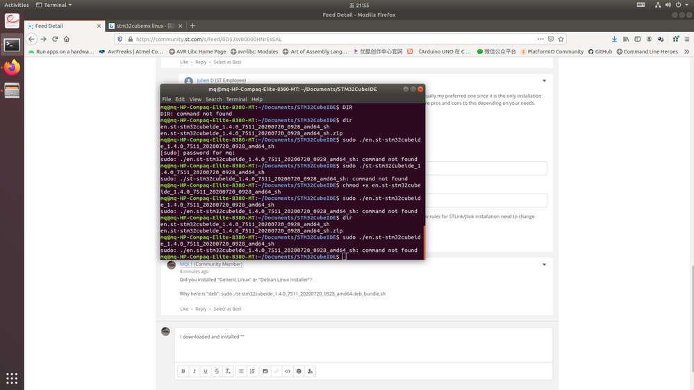

MQi.1
Senior II
I downloaded and installed "Generic Linux", and got these:
Quick answer is both.
"Debian Linux Installer" requires sudo on the command-line since calling the package manager (apt, dpkg) has to be done as admin.
STM32CubeIDE will be installed in /opt/st/, owned by root, and shared among all workstation users.
"Generic Linux" does not necessary requires sudo on the command-line. Don't use it to enable the self-update feature in STM32CubeIDE, this is how I usually install the tool.
STM32CubeIDE will be installed where you want, owned by you or root (sudo).
I do not see the .sh script, are you sure that you're not trying to execute the extracted folder from the zip archive.
Try cd en.st-stm32cubeide_1.4.0_7511_20200720_0928_amd64_sh first and do the chmod command on the .sh file.

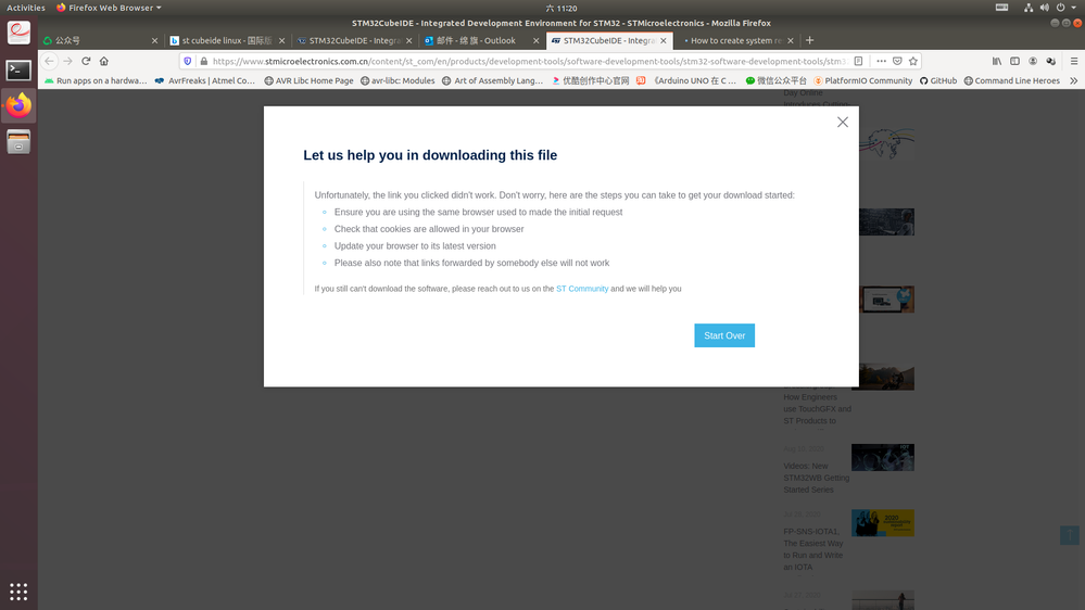

MQi.1
Senior II
I could only download "STM32CubeIDE Generic Linux Installer", since when I downloaded "STM32CubeIDE Debian Linux Installer", it would also sent me a link, but when I clicked the link, it prompted:
