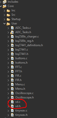

In the code I deleted #include "fatfs.h" line in main.c. After that, I created 2 new files called "sd.c" and "sd.h" in /Core/User folder which i've created.

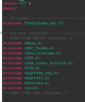

main.h file:
#include "sd.h"
/* USER CODE END Includes */

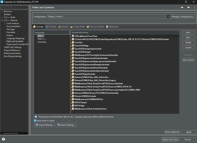

Look at the Include Paths settings and make sure that your project has the right include paths and the compiler knows the path to fatfs.h.
2024-01-07 11:38 PM
Hello @Imen.D
I don't see any problems with the include paths. Here are my include paths and files:
Include paths:

main.h

2024-01-07 11:48 PM - edited 2024-01-07 11:48 PM
I also get errors if i move #include "fatfs.h" from main.c to main.h. Normally, when i created the project, "fatfs.h" is already included in main.c. If I don't include "sd.h" file to "main.h" and just move the inclusion of "fatfs.h" from main.c to main.h, i get the same errors.
