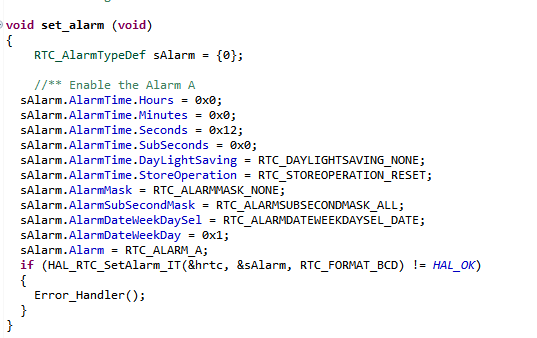

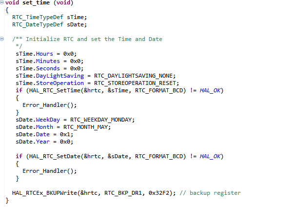

HI thanks,
I started implementing RTC in STM32Cube IDE for STM32L151RCT6 MCU...
After addition of RTC module i enabled activate clock source, activate calender and kept all default settings , only i changed alarm settings : sec: 12 sec and generated the project and took 2 functions out ;
Set alarm and set time : my requirement is after doing some calculation i need to start 12 sec timer and in that time collecting samples and after 12 sec doing the average calculation..... i am not getting how to use set alarm function , if directly i used without setting time means will it work?
please help me to resolve it.
Set time :
