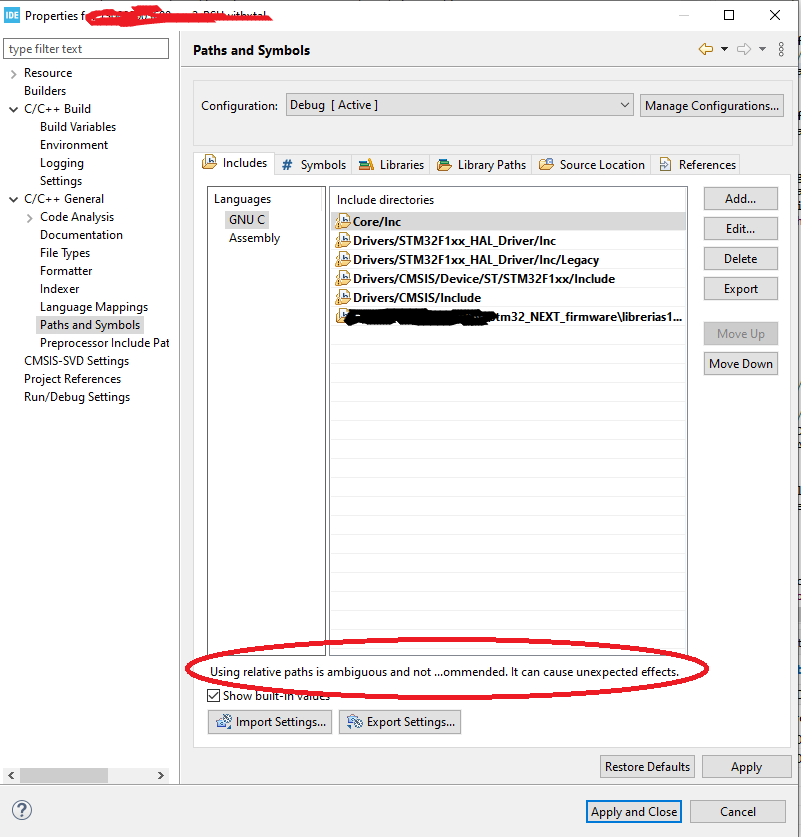

Im not sure im understanding your question.
But i am able to include libraries in relative paths (windows)
Bevare of their disclaimer
