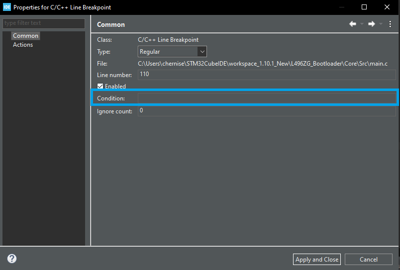

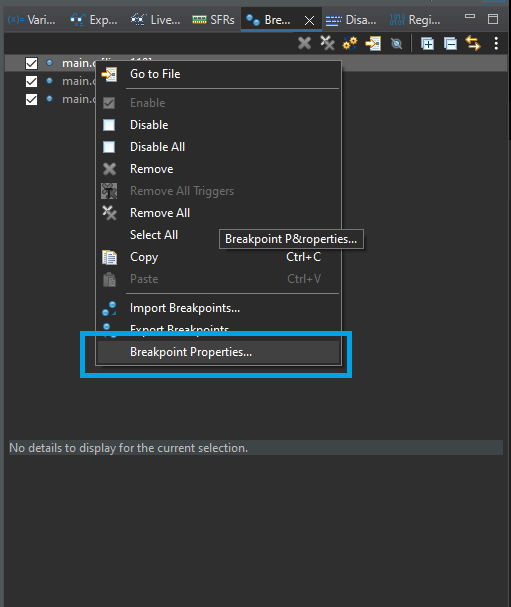

Hello @PSimo.4
In fact, such feature is implemented in STM32CubeIDE.
In the debugging view go to the Breakpoint view and right click on the breakpoint where you want to add a condition.
Open the Breakpoints Properties menu and add the stopping condition.
Kind regards,
Semer.

2022-10-11 12:01 AM
Thx a lot !
As Condition may I write « var == 5 » (if var is a correctly declared variable ?)
