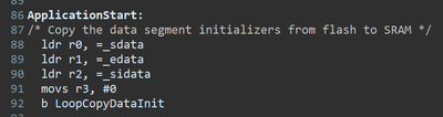

The default startup file generated by CubeMX initializes SRAM appropriately and uses the _sdata and similar variables. For example, here is an excerpt:
The startup file is typically named startup_stm32*.s
You can, of course, modify the startup file however you want as long as you do the necessary things inside of it.
Edit:
The _sdata and similar get defined in the linker file, which depend on the sections you define in there. Maybe that's what you're missing. You'll have to ensure the sections for each program do not overlap at all, then it should just work.
Seems a whole lot easier to make one program rather than 3. But the scheme is certainly doable.

Thank you for the valuable information for me. I found them in Cube IDE. However, in Keil there is no linker file, instead I found a scatter file. Maybe it is not possible to create branch conditions in the scatter file?? Can I create a linker file to replace the scatter file?
In your code snippets above, no changes in linker or scatter files were needed. Just set correct ROM and RAM addresses for each app in Keil project options and you're done.
