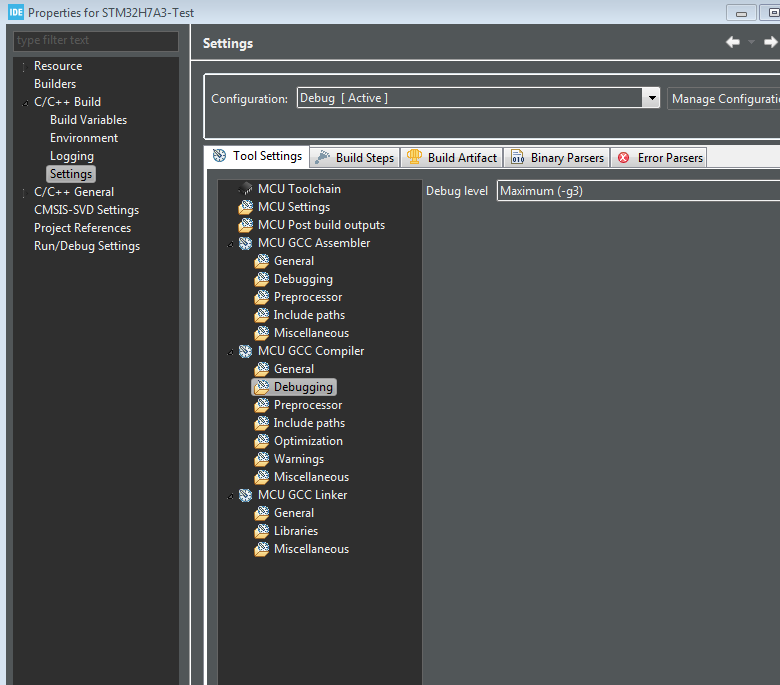

2023-02-08 5:03 AM
maybe , look in Project -> Properties ...
