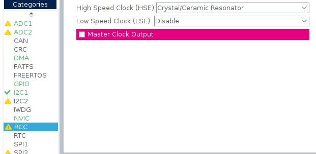

According to the data sheet for this device, I should be able to attached an external High speed crystal instead of using the HSI RC. However, I can't seem to figure out how to do this using the STM32CubeMX utility.
2023-01-29 11:45 PM

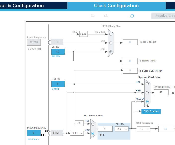

so simple:
2 . set frequ.in clock tree and pll
ok ?
