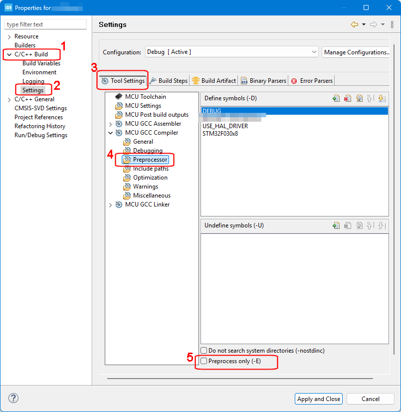

But the option you require is here:

@Andrew Neil
I originally tried that, but didn't find the pre-processor output.... Eventually, i figured out that the *.o object files contained the expanded C code.  (not obvious)
The standard command line tells the compile to call its output file .o
So, when the generated output is the preprocessor output, it goes into the .o file.
Indeed, it makes sense once you know - but it's not obvious before you've found out!
