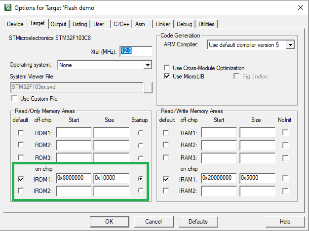

Is it possible to change the IROM address using STM32CubeIDE 1.3.0 ?
since the default IROM address is started from 0x08000000. So, I would like to change it to 0x08002000.
I attach a screenshot. Please see the picture.
Please help. Thanks.

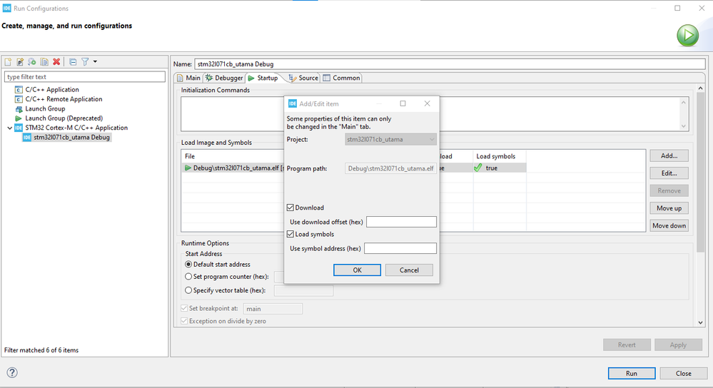

2021-01-23 5:52 AM
I can't find the config dialog too. But the memory is defined in "STM32xxxxxxxx_Flash.ld", I think we can modify it manually. I am a newcomer to CubeIDE, Not tested..
2021-01-25 1:59 AM
@LJim advice is right one. No UI if STM32CubeIDE about memory(ies) definition. Right place for is linker scripts (*.ld file(s))

Please see this picture, this way is solve my problem.
Open Run Configurations > Click on Startup tab > Click the available startup > Click Edit then this dialog will appear on your monitor.
Write the offset in hex, in this case, my offset is 0x2000. So, the program will start from 0x08002000 (0x08000000 + 0x2000)
