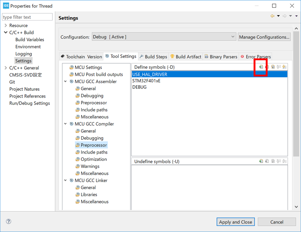

#error "Define according the used Cortex core ARM_MATH_CM7, ARM_MATH_CM4, ARM_MATH_CM3, ARM_MATH_CM0PLUS or ARM_MATH_CM0"Based from this Topic https://community.st.com/s/question/0D50X00009XkXPtSAN/need-help-in-dsp-library-for-keil-
The problem is solve by adding the preprocess symbol in Keil Uvision, What is the equivalent of this in STM32CubeIDE?

To add preprocessor symbol is...

What is the best way to use these symbols in your code? I am having trouble with compiling my code when referencing symbols defined this way.
