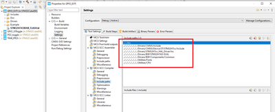

For .h files, you need to give the path(s) to that files as include paths:
Proprieties -> Settings -> MCC GCC compiler -> Include Paths:

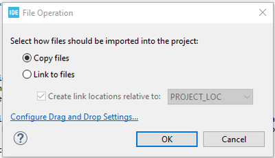

For .c file you need to drag and drop the file to the Project explorer at the level you want. You will get this message:
Click OK. The file will be added to you project.
