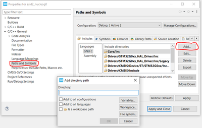

In the main menu go to Project -> Properties -> C/C++ General -> Paths and Symbols. Then add your folder.

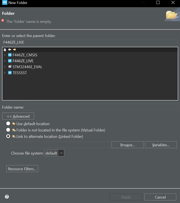

In order to add an existing folder to STM32CubeIDE project , try to add it using an advanced link. So, Right click on the existing project, then, click on "New Folder" and use the option "Link to alternate location" as shown in the screenshot.
Also, include the path to the project via "property->c/c++ build->setting->toolchain->mcu gcc compiler->include paths".
