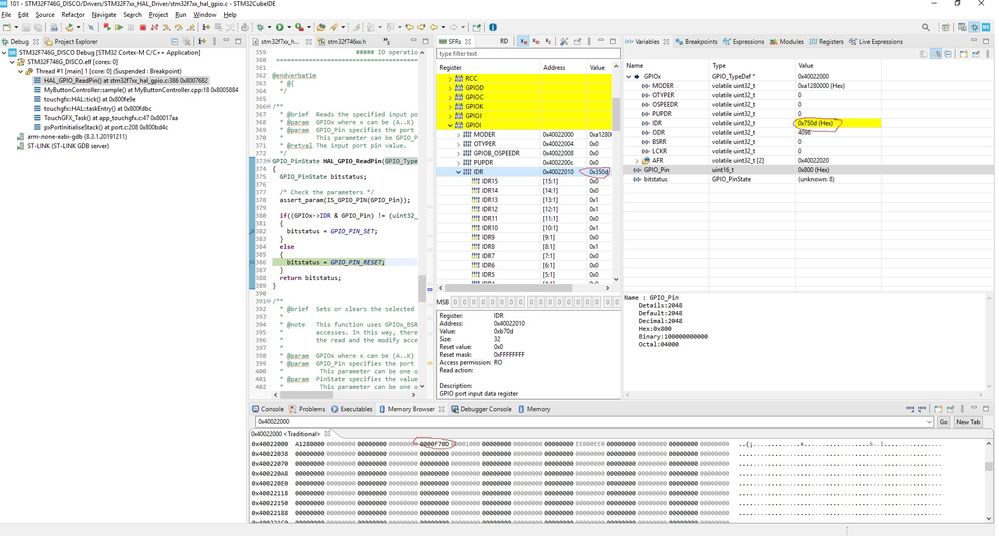

Hi! I am start work with STM32CubeIDE last time and I did not understand:
STM32CubeIDE
Version: 1.7.0
Build: 10852_20210715_0634 (UTC)
2021-09-08 7:47 PM
2021-09-09 8:25 AM
The debugger doesn't constantly refresh registers. If IDR is changing, it will report the value at the time it was retrieved. If you have it displayed in two different locations, they may differ.
