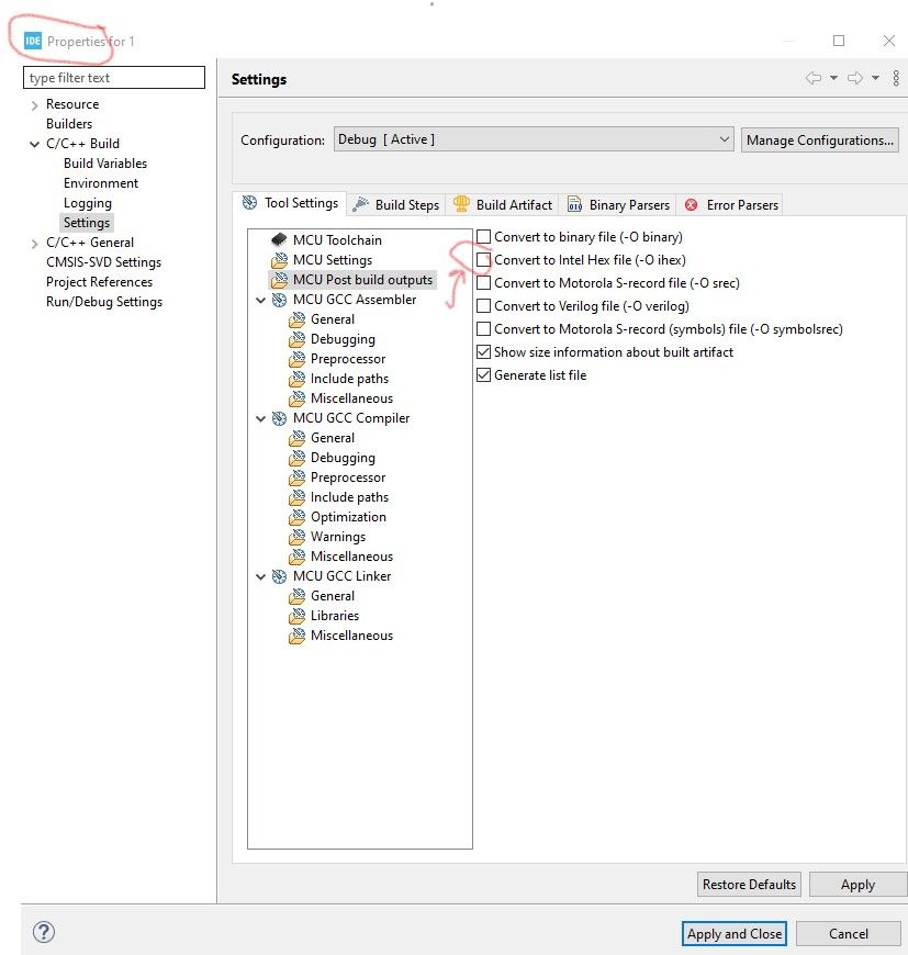

Despite I would be worried about such missing arm-none-eabi-objcopy.exe file as sounds post build step doing .elf to .hex is failing have a try to just skip it. .hex is just an extra binary you don't care about. .elf is far best one.
Just right click on your project root within project explorer. Select Properties as part of contextual menu then uncheck .hex generation:
2021-02-11 12:18 PM
