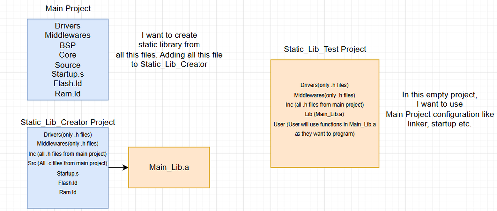

I want to create static library from my code to share the artifacts (but not the code). I will call this Main_Project.
In my Main_Project, I have startup.s and flash.ld files.

.syntax unifiedI created static library named "Main_Lib.a" using all source and header files in my Main_Project.
After this point, I created an empty project is named "static_test". In this project, I added "Main_Lib.a", include files etc. After that, added static library to makefile as below but static_test can not find vector table from Main_Lib.a because I do not know how to implement that in empty project from a static library.

How can I show or add my startup.s, tx_initialize_low_level.S and flash.ld configurations to static_test project?
