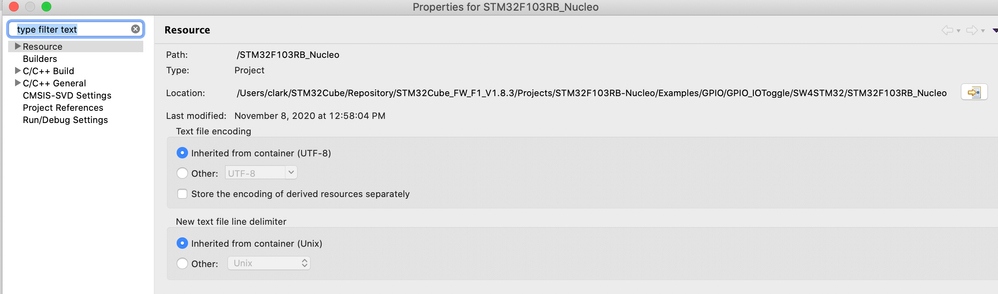

Here is my project path immediately after successfully importing. Please note that the path is pointing to the MCU Software Package repository. Then, as soon as I rename, the repository is damaged and I have to delete the F1 repo and reinstall it.

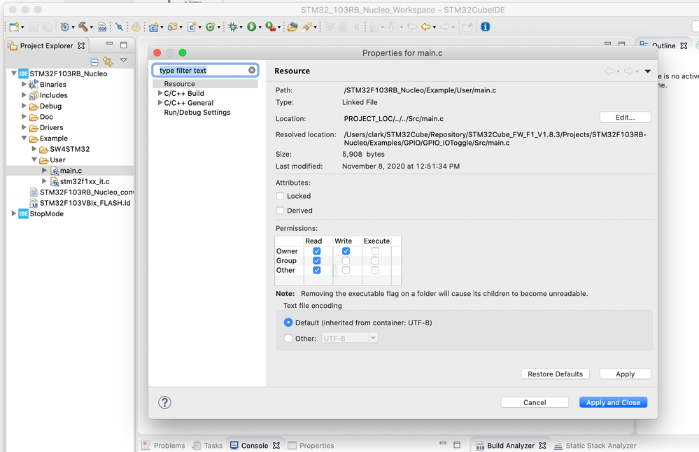

Properties of main.c after importing.

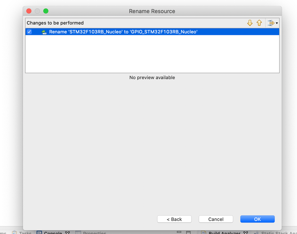

The preview screen for the rename command

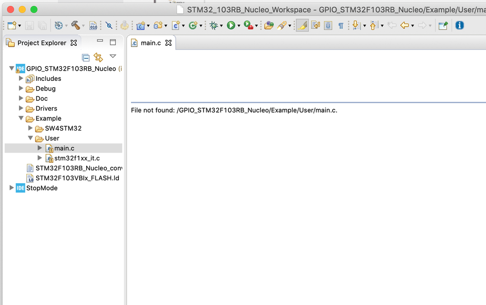

The properties of main.c after rename
It's gone! We are doing either the import or the rename differently. I wonder if it is not the import. The import is leaving me editing the repo. I am not sure you are doing the same thing. I wish the import copied files into my workspace so I wasn't messing around in the repo.

Definitively weird.
I see you're working on MacOS. Myself relying on Win10 OS.
So just got a try on my iMac ... leading to same trouble as you :( ... sounds Eclipse behavior not same at all doing project renaming if MacOS.
Doing renaming based on a Linux VM is doing same as Win10.
2020-11-08 11:48 AM
That certainly explains the error. I might try running CubeIDE on Linux. I have a Linux VM. Or I might just examine the examples to learn what I need and then get comfortable changing the project templates built using Target Selector. Actually I think the latter is the best approach.
